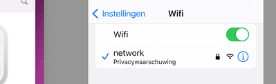

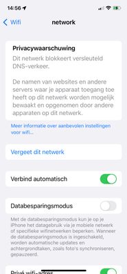

Dear community, I have a BR200 with firmware 5.10.0.5. I have succesfully setup multiple vlan's and corresponding DHCP services it is all working nicely. However, the iPhone complain that the...

For my curiosity, would you mind to share a screenshot of the iPhone complaint?

It's in Dutch. Roughly translated: one picture says "privacy warning". And the other explains that the DNS service (a.k.a. the Netgear router) is intercepting the DNS traffic and could potentially monitor this.

Figured out - these DNS privacy warning does come up along with this "Private Wi-Fi" random MAC enabled. Apple managed to bring a little bit of thier lost trust back: Appears they understand now the Private Wi-Fi along with their privacy concerns affect more "public" Wi-Fi.
On your home or business network, one would assume your legal and trusted users have nothing to hide. Disable this "Private WI-Fi" ***** for your wireless network name(s) in your very own network.
