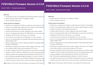

FVS318Gv2 Connectivity Issues with Firmware 4.3.3-8
This is becoming extremely frustrating... I have a Netgear FVS318Gv2 which works fine as long as it stays up for the first 10 minutes. It will run flawlessly until a power outage. Then good luck ge...
