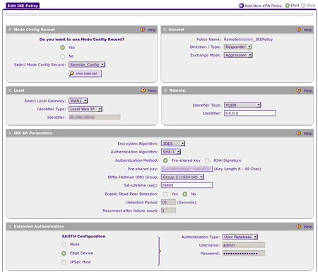

The Documentation:
The Instructions:
The Screenshot from the Instructions:
'Tis an unusual paradox. One must enable Mode Config to enable the use of XAUTH & Edge Device options. But the directions clearly state, and show, that Mode Config is NOT to be enabled.
The Instructions:
There is no Policy Type 'Responder' from the dropdown list, but perhaps this is meant to be taken more generally (it is in the General section), since we are ultimately building a Responder IKE / VPN policy.

Thu Nov 24 18:07:36 2016 (GMT -0500): [SRX5308] [IKE] ERROR: Local configuration for 192.168.4.21[500] does not have mode config
Thu Nov 24 18:07:36 2016 (GMT -0500): [SRX5308] [IKE] INFO: Received attribute type "ISAKMP_CFG_REQUEST" from 192.168.4.21[500]
Thu Nov 24 18:07:36 2016 (GMT -0500): [SRX5308] [IKE] INFO: XAuthUser RemoteVossnetUser Logged In from IP Address 192.168.4.21
Thu Nov 24 18:07:36 2016 (GMT -0500): [SRX5308] [IKE] INFO: Login succeeded for user "RemoteVossnetUser"
Thu Nov 24 18:07:36 2016 (GMT -0500): [SRX5308] [IKE] INFO: Received attribute type "ISAKMP_CFG_REPLY" from 192.168.4.21[500]So, it appears that XAUTHUSER will work for authentication purposes without mode config, but then the tunnel collapses becauses it doesn't have a mode config.
Attempting to provide a Mode Config and make use of a VPN Policy results in this error message:
I am confused.
