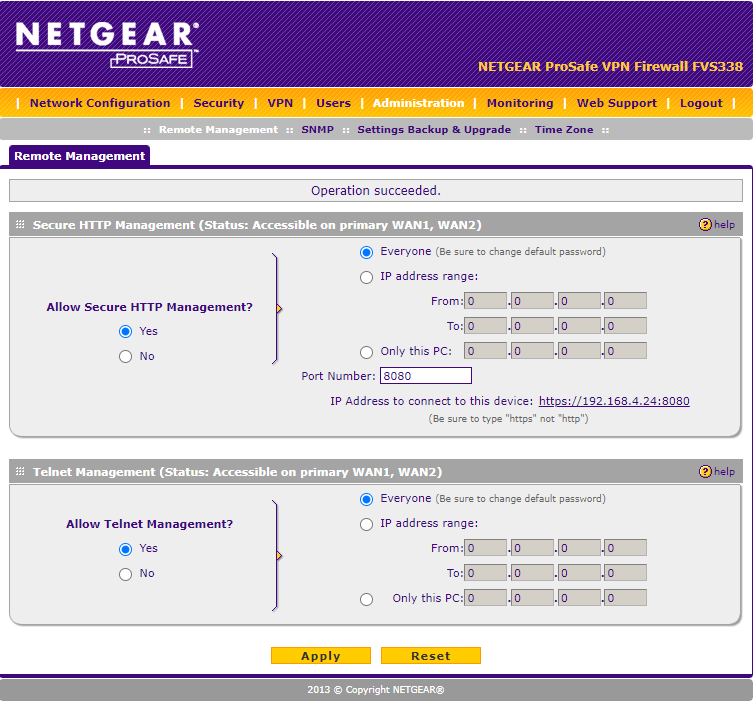

Sep 04, 2023Aspirant
I have this option set as in the attached picture but I still can't connect. The computer from which I am connecting has the address 192.168.4.11 and the router 192.168.4.24.
Does WAN access require other options to configure?
