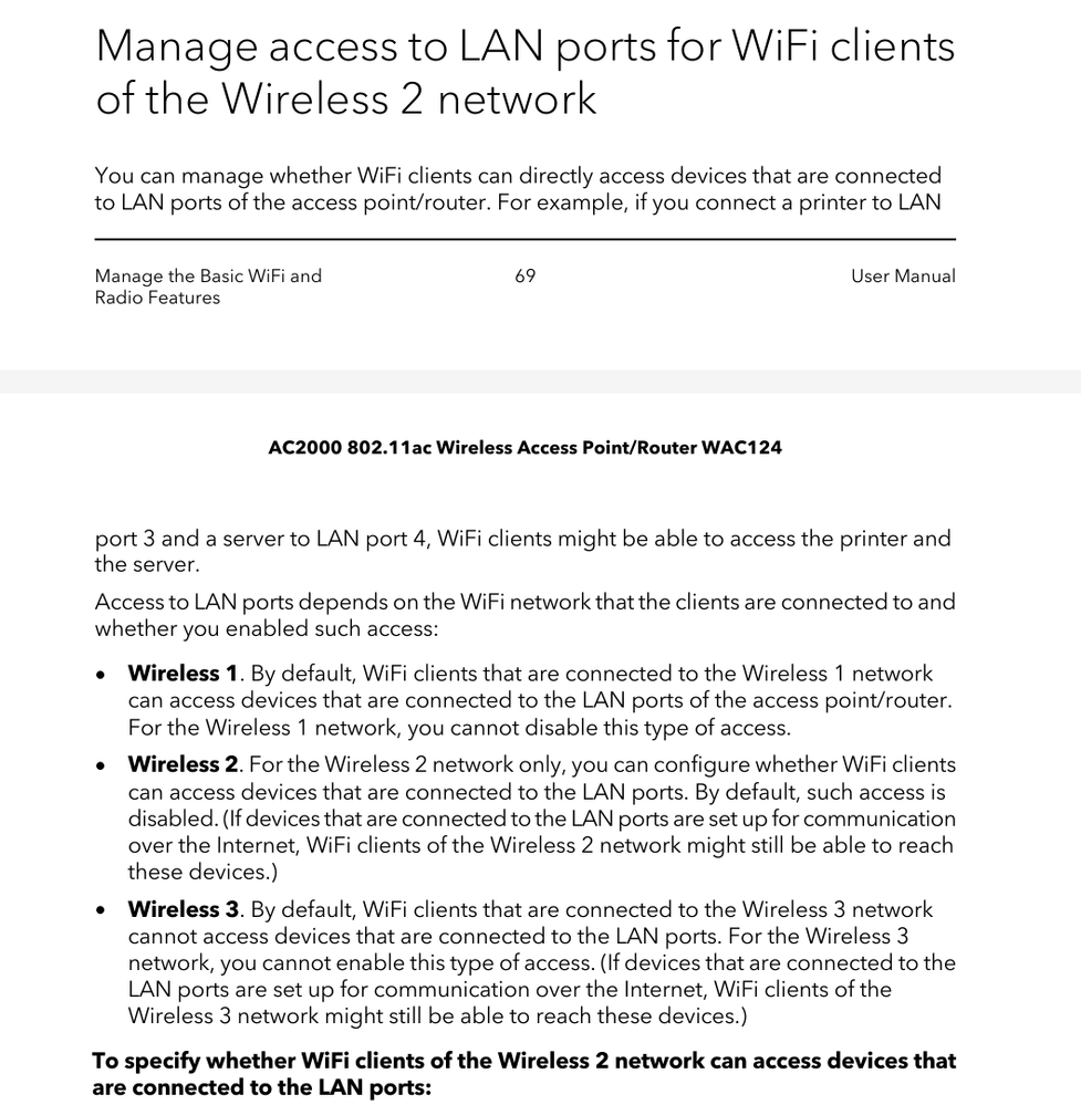

...it's finally working as it should, or almost. I'll have to see if they finally fixed the restrictions on the guest access, which were not enforced correctly before (I'm not expecting any improvement).
Guest network? There is no such thing on this router/AP model. Yes, of course you can configure three Wireless SSIDs, Wireless 1, 2, and 3. There is only a simple access control to the LAN ports for the "Wireless 2" wireless network - and nothing else.
