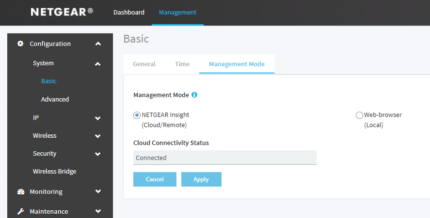

There is nothing to be solved, and no reason to return anything.
The default is always Netgear Insight (Cloud/Remote) management - following a factory reset, following the removal from Insight. Just flip the switch on System -> Basic -> Management Mode

- MyAntonAspirant
Thanks. I needed first to perform a HW reset without having an internet connection. Then I could access the AP as written above. After that everything worked perfect.
