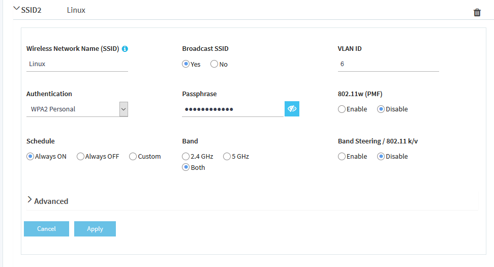

To your first point, yes, all of the VLANs are tagged except the default. I've also included a screenshot of the VLAN configuration. The WAC510 is plugged into LAN 5. Still, the SSID with VLAN 6 (Linux) has no Internet.
To your second point, do the AP LAN settings affect the Wi-Fi tagging, or is this part just for management?

Vectro wrote:To your second point, do the AP LAN settings affect the Wi-Fi tagging, or is this part just for management?
That's just for the explicitly listed management VLAN. The SSID<->VLAN association does make use of tagging regardless of that setting.

I've attached my AP config. I made a mistake in my last post. I actually had The Windows SSID on VLAN 1 by mistake. When I set it to VLAN 5 (where it's supposed to be), it doesn't have Internet, either. That still tells us something, only VLAN 1 gets Internet on the WAC510. On the client device, both SSIDs fail with the error "Unable to obtain IP address". Again, works fine with a Cisco AP.
- VectroJul 31, 2019Aspirant
Another screenshot of AP config continued from last post.
