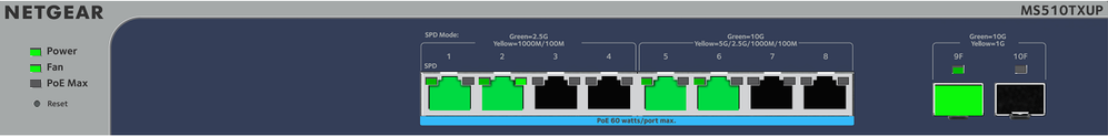

Each device is connected to a switch in my rack. It is a Netgear 8-port MS510TXUP. While there are 8 ports, the first 4 appear to go up to 1Gbps, while the next 4 appear to support up to 2.5Gbps. So, I plugged the WAPs into the second 4 ports to maximize performance. But that may be unnecessary/overkill. Thoughts?
- schumakuSep 27, 2022Guru - Experienced User
For WAX620 using switch ports supporting 2.5 GbE is about right - anything is a waste of the WAX capabilities.
The MS510TXUP (assume this information is correct) have four 100M/1000M/2.5G, plus four 100M/1000M/2.5G/5G/10G, plus two MultiGig capable SFP+ slots with up 10 Gb. Similar for the MS510TXM (no PoE/PoE+/PoE++). The older MS510TX and MS510TXPP have a mix of four GbE plus four MultiGig ports.
This read more like a MS510TXPP (or MS510TX and external power supplies to the WAX620). In this case, the four 2.5GbE ports are the correct choice.
