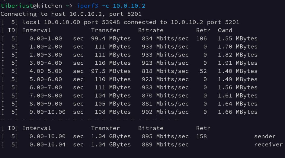

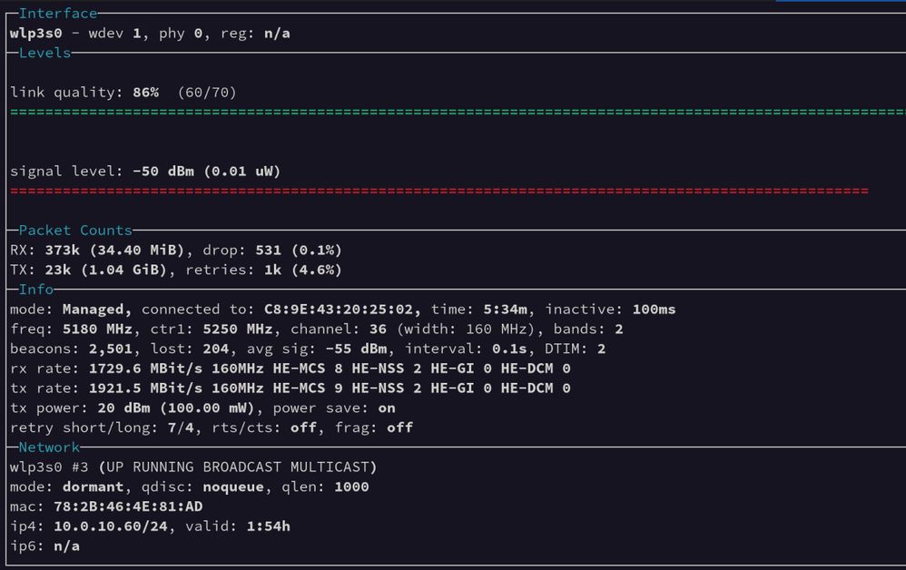

Fixed...But it wasn't straightforward. I first put the management LAN back to 1. No change. After a fruitless hour or so messing about, I then did a full reset, got a client onto VLAN 1 and all was good. I then enabled another VLAN, connected to it from same client and speed was down to 40 Mbps again 😒 There then followed a mass of changes/tests/reboots but weirdly it wasn't until (as a desperate last effort) I set up a DHCP server on PfSense on 192.168.0.1 (no VLAN) and set the WAX to DHCP client, that the Ethernet speed returned to normal (abt 800 Mbps). WTH??!!! 😥The WAX was definitely not responding the way it should throughout this process. I conclude that the firmware is ... buggy.
Still, when it works it is excellent. Great coverage, stable signals, and very fast as evidenced by my tests below. The iperf test shows a PC (Kitchen!) with an 'Intel Wi-Fi 6 AX200', mounted under a desk about 7 meters distance from the WAP through a thick plasterboard wall, to another client (10.0.10.2) on the same network that is cable connected to the same switch as the WAP. So, a full test of Wifi and Ethernet. The other picture is the excellent 'Wavemon' package which shows what and how your interface is connected to the Wifi. I am connected at 160Mhz 🙂 - outstanding given the lack of proximity.
