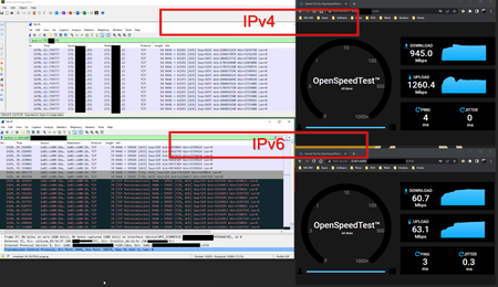

Hi All, My WAX630E is not playing well with IPv6. Lots of TCP retransmissions for traffic coming through the WAX630e when IPv6 protocol is used, IPv4 traffic comes through the AP just fine. ...

This morning I did some more testing and when device is connected to SSID on WAX630E which uses default VLAN IPv6 traffic runs at full speed.
So performance issue and TCP retransmissions is happening only on VLAN SSID's.

Problem:
Multiple SSID on my access point with multiple vlan
IPv6 traffic on any vlan other than the default "vlan 1" is limited to 40-60 mbps.
IPv4 traffic on all vlan's is working just fine, not throughput limitation
