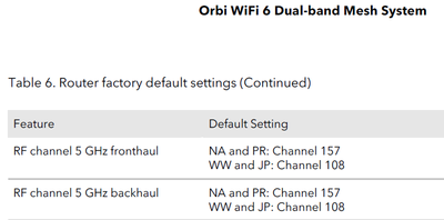

    As far as changing channels. The 2.4G channels 1-13 are available in Germany. According to page 128 of the user manual, the 350 system is set to channel 108 and I am not certain that it can be changed.
    https://www.downloads.netgear.com/files/GDC/RBK352/RBK352_RBK353_UM_EN.pdf
