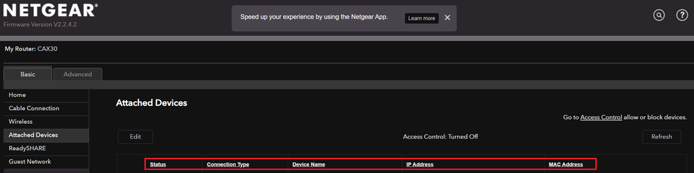

Checking someting today with the WEB UI, using MS Edge in Windows 11, on the basic tab/connected device page,
The column headers for each column, they are selectable however are not doing anything when selected. Would be a great feature to have this ability to sort the columns with any of these headers:
Especially by IP Address. 😉
