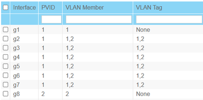

jasonh77tw
Oct 23, 2023Aspirant
Hi schumaku
Thanks for your advice, I configured the switch like this and it works.
I can access different internet connection through different SSID now, but I'm wondering that is it really safe? I mean are devices using SSID A/VLAN1 really isolated from devices using SSID 2/VLAN2?
Thanks again.
- schumakuOct 23, 2023Guru - Experienced User
Have to guess...
g8 is connecting to the router 2 making the VLAN 2, it's IP subnet, and the matching Internet access available?
g1 is connecting to the router 2 making the VLAN 1, it's IP subnet, and the matching Internet access available?
The two SSIDs are assigned to the VLAN 1 (intentionally both untagged and tagged?) and VLAN 2 (tagged), the AP (or the APs) are connecting to g2...g7.
