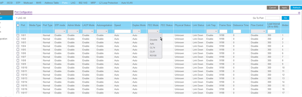

    Last, on 25G, don't forget you might need to configure another FEC mode than our default FEC mode on the SFP28 25G ports. Please upgrade your M4350 switch with our latest 14.0.2.17:
    After the upgrade and the reboot, please go to the IT GUI, Switching\Ports\Port Configuration, and select the SFP28 port you want to test, then select maybe another FEC setting in the dropdown menu (FEC Mode column):
    Please let us know (but you need to do either all 10G or all 25G on these four SFP28 ports!)

      My firmware needs updating as I don't see the 'FEC' columns in the port configuration page. But you said, "Don't forget you might need to configure another FEC mode." However, I don't see mention of FEC or Forward Error Correction in the user manual or data sheet for this device. Did I miss this somewhere?
      I will update the firmware, try some different FEC setting[s] and report back.

        And FEC is a setting for 25G and 100G because optics used in transceivers, NICs, and other network devices can differ hence FEC sometimes need to be configured right for specific devices. We have default Auto-FEC but in our recent firmware you will find this setting. Please upgrade to 14.0.2.17 from here: https://www.netgear.com/support/product/m4350#download
