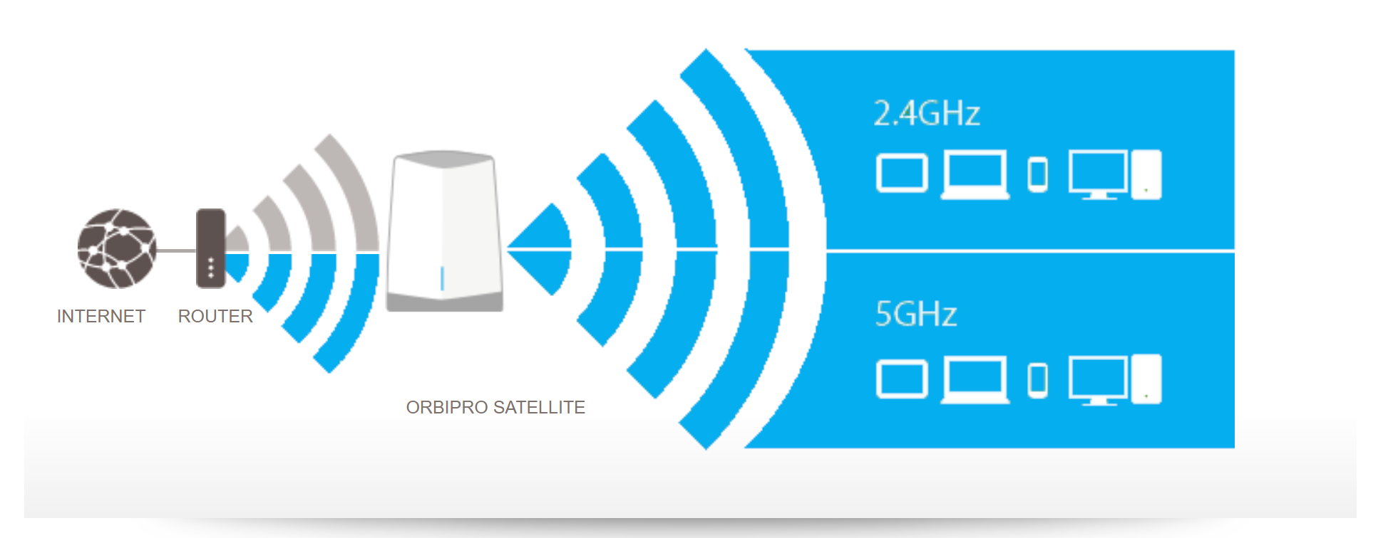

I have just upgraded from RBK50 to SXK80 and I have some questions:
I configure AP mode on Router SXR80
1. How can I enable 2.4GHz & 5GHz on Satellite & Router? In RBK50, 2 bandwidths will be enabled.
    According to your screenshot, the satellite is active on both the 2.4 and the 5 GHz band.
