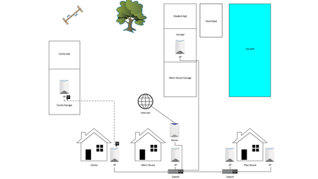

Orbi Pro Design Validation (SRK60B06) 6 Satellite Deployment with Wired Backhauls
Hello all,
I've included a rough diagram I was hoping to get validation for. I'm less concerned about coverage as the diagram isn't to scale but more interested in whether the wired back...

BooJangles
Jul 08, 2019Apprentice
Hi DaneA,
Thank you for your response. I reviewed the link and just want to make sure the wired backhaul will work correctly if going from one switch to another before the router. In my diagram you will see 2 satellites pluging into a switch (Playhouse) then that switch is connected to the main switch (main house). The router is connected to the main switch.
If this works, are there any special considerations in how I power on and sync things?
Thanks again,
B
ShawnC
Should be fine unless you have something special going on in your switches that would effect IP 4/6 routing (port forwarding, packet shaping, etc...)
-Shawn C
