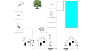

Orbi Pro Design Validation (SRK60B06) 6 Satellite Deployment with Wired Backhauls
Hello all,
I've included a rough diagram I was hoping to get validation for. I'm less concerned about coverage as the diagram isn't to scale but more interested in whether the wired back...

Welcome to the community! :)
About setting up the Orbi Pro System for Ethernet backhaul, kindly access the article below and see the recommended network setup:
What is Ethernet backhaul and how do I set it up on my Orbi WiFi System?
Make sure that the firmware version of the Orbi Pro System should be v2.1.2.18 or higher for Ethernet backhaul to work. The latest firmware version is v2.3.5.106 and you can download it here.

- BooJanglesJul 18, 2019ApprenticeSo far I have the router and 3 satellites setup. In my experience thus far the recognition of new satellites has been inconsistent regardless of being added from Insight or Orbi app. Both apps say it failed but ultimately after a long 5-10 minutes of no response and self reboots they eventual show up.
When updating the firmware it is similar process and when checking for updates online it says none are are needed but what is installed is several revs behind. I ended up performing them manually from the web interface and had to do them one at a time even though it let me select them all for update.
Question: I will be needing more satellites than anticipated due to dead spots, what is the limit of satellites that can be added?

B- DaneAJul 18, 2019NETGEAR Employee Retired
One (1) Orbi Pro router (SRR60) can now support up to seven (7) Orbi Pro satellites which is either the Orbi Pro Add-on Satellite (SRS60) or the Orbi Pro Add-on Ceiling Satellite (SRC60). Be reminded that the firmware of the Orbi Pro devices should be updated to the latest firmware version.
Note: The Orbi Pro WiFI System is NOT compatible to pair with the Orbi Home WiFi System.
An Orbi Pro router and Orbi Pro satellite pair can cover up to 5,000 square feet. Each additional add-on satellite (either the Orbi Pro Add-on Satellite [SRS60] or the Orbi Pro Add-on Ceiling Satellite [SRC60]) can cover up to 2,500 square feet.

- BooJanglesJul 24, 2019ApprenticeDoes this exclude the outdoor satellite (RBS50Y)? You only reference the SRS60 and SRC60.
