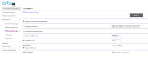

Orbi SXR80 and IPTV from ISP Telenor
Hello We experience problems with IPTV provided from Telenor, wich is a Norwegian ISP which also delivers IPTV via a box connected to internet. The TV box is connected to a Orbi satallite with...

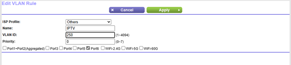

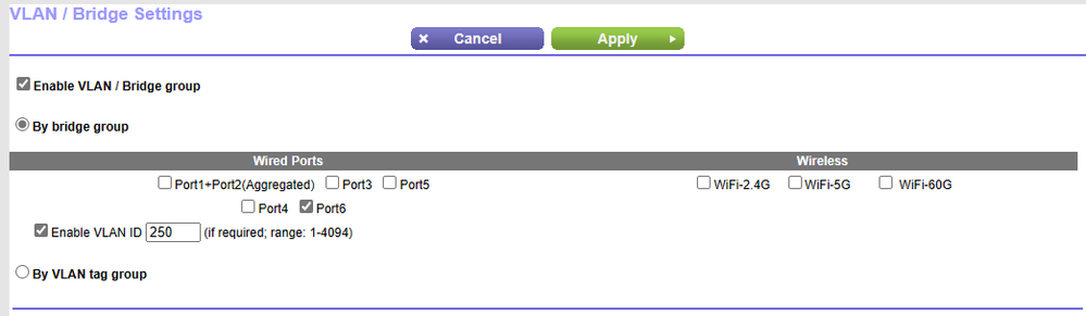

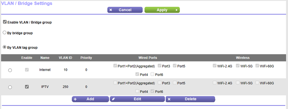

I still fear the SXR80 is still limited to the same config options like the R9000 for example (and many other Netgear routers before and since...) on the Bridge Group ans VLAN Tag Group:
Said this: In either way, all you can do is assign one (or multiple) LAN ports of the router, where you could connect the IPTV Settop box. And No: This IPTV VLAN can (sill!) not leave the router e.g. over the wired or wireless backhaul - the Orbi Whole Home system is limited in this aspect, the IPTV network is not tightly integrated in the similar way ISP provided routers do, where user can add either direct connected IPTV Settop boxe(s), or add a switch (configured to support IGMP Multicast).
@ThomasNorway - that's why I've asked ref. your Orbi Pro SXR80. Are there no similar controls on your router? The SRS router would bring the VLAN support for the LAN 8-/
