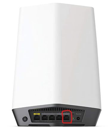

I still fear the SXR80 is still limited to the same config options like the R9000 for example (and many other Netgear routers before and since...) on the Bridge Group ans VLAN Tag Group:
Said this: In either way, all you can do is assign one (or multiple) LAN ports of the router, where you could connect the IPTV Settop box. And No: This IPTV VLAN can (sill!) not leave the router e.g. over the wired or wireless backhaul - the Orbi Whole Home system is limited in this aspect, the IPTV network is not tightly integrated in the similar way ISP provided routers do, where user can add either direct connected IPTV Settop boxe(s), or add a switch (configured to support IGMP Multicast).
@ThomasNorway - that's why I've asked ref. your Orbi Pro SXR80. Are there no similar controls on your router? The SRS router would bring the VLAN support for the LAN 8-/

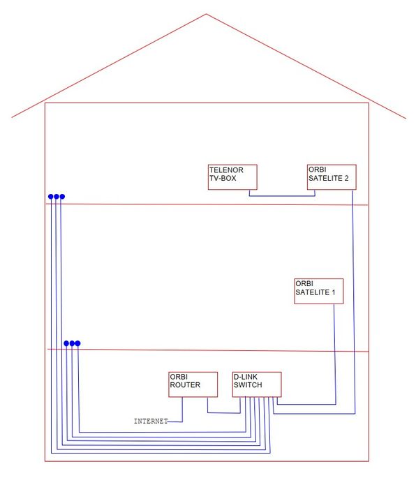

So, with your suggested configuration as described below, I need to plug the TV box directly to the router on the assigned port?
The problem with that, is that the router is located on the 1st floor, and the TV box is on the 3rd floor.
See arrangement below.- schumakuJan 04, 2024Guru - Experienced User
Yes, this is the only approach I can see currently.
See arrangement below.Would love to suggest a better solution 8-) Operating a slightly more complex network on a similar wiring infrastructure, at the price of using Smart switches, fully supporting IGMP multicast, dedicated VLANs all through the house, including one VLAN for IPTV - this allows me to connect ISP provided TV boxes in each room
