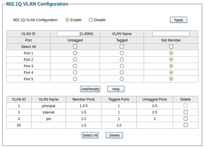

- hiwiJan 27, 2023Tutor
I configured Vlans on my managed switch :
