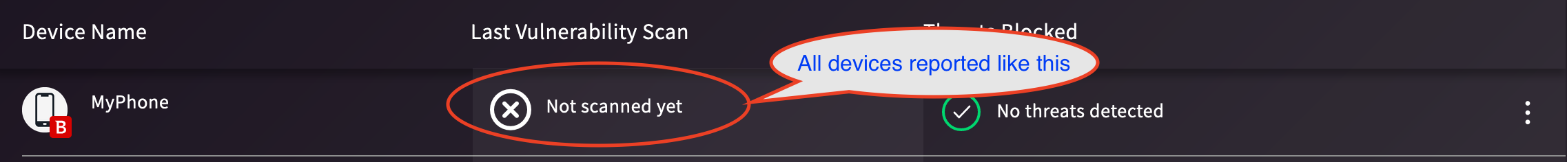

Armor on R8000 does not run Vulnerability Scans
9 days ago I activated the 30 day Armor trial on my R8000 router (Firmware V1.0.4.46_10.1.63) with the primary aim of leveraging the Vulnerability Scan capability for the many devices I have on my n...

Hi sph70 . The vulnerability scans will run. The article you quoted means that a vulnerability scan is done the first time you connect a new device to the network; and weekly thereafter. But that weekly schedule is tricky; unless your devices are on line when the scan is scheduled, the scan will be delayed till the following week. Unfortunately, there is no option for user-triggered scan at this time.

sph70 . I presume that you check the vulnerability scans at the Netgear Armor Portal, is that correct?
- sph70Nov 12, 2019AspirantYes - I attached a screenshot from the portal to my original post. The only other place I’m aware of that shows the status is the Nighthawk app which also shows no scans performed.
There is nowhere on the R8000 itself that reports anything regarding Armor other than it is enabled.
