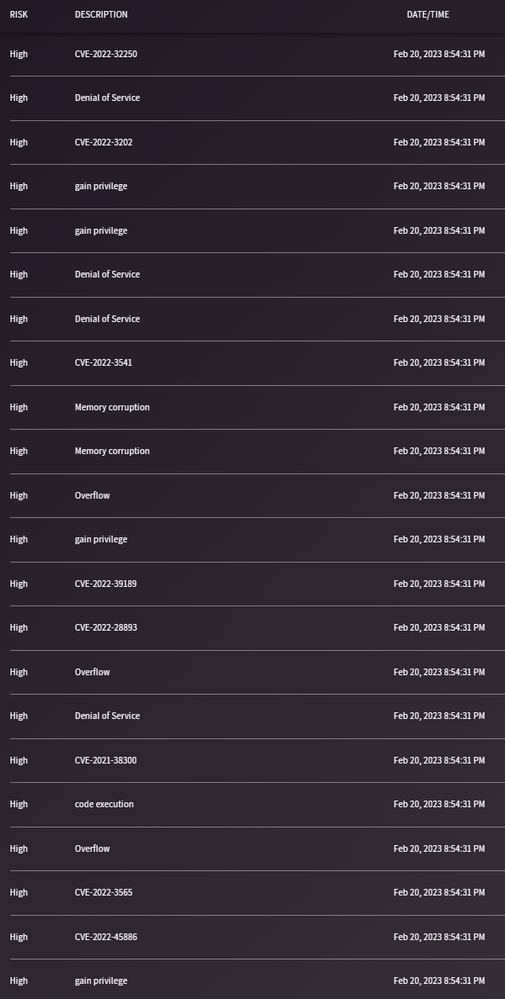

So, I decided to take the plunge and remove the LG TV Device from my Armor devices. After giving the TV a new IP Address, I received a message that Armor had found the TV, scanned it, and found 112 vulnerabilities! So, it's definitely not a scanning error that first time, but definitely a choice between false positives or true vulnerabilities in the LG TV.
Also, instead of "just" 83 vulnerabilities, it now finds many more vulnerabilities. The firmware of my TV is fully updated and currently runs Software Version 03.30.16.
Here's a list of the first bunch of vulnerabilities that are reported by Armor.
List of the first bunch of vulnerabilities reported by Armor.
