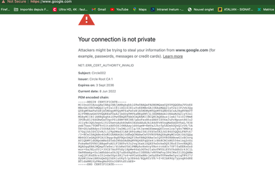

Circle Certificate seems to have expired
Hi, I've struggling with connectivity issues in my home for the past few days. I have been rebooting my router few times, reinstalled things, no changes. Turns out, I noticed I could no longer go ...

Can you post a screen capture of the Chrome message describing the Cert issue?
PIerreSc
Jun 08, 2022Aspirant
Hi,
Here you go !

Thanks for the screen capture. Notice that the error message is not that the certificate has expired, but that the Certificate Authority is invalid. This is not the first time users have noticed this particular situation:
I found several previous posts about this specific topic (including one where I totally failed to find a solution).
