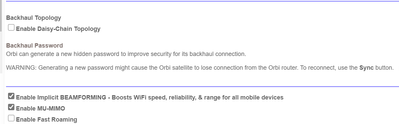

I will give reset to factory settings a try - ThekrakenJun 18, 2020Tutor
Hi All
Took Piupolino's suggest to do a factory reset on my Orbi system, and things seem to be working fine. Previously, it was a daily occurance that I had a drop out. After the factory reset it's been 5 days and I haven't had the same kind of drop out, although I had another strange router freeze (different behaviour from previous) and not sure what caused that.
So it went like this.
1. Update Router and Sat to the latest firmware version: V2.5.1.16
2. performed factory reset on both Router and Sat.
3. Reconfigured everything, connecting the Sat to the Router as well.
4. Set new SSID ( just because i wanted to)
5. Kept most settings as default on router:
Notes:
* operating in Router Mode
* the only settings I've changed compared to pre-factory reset is below. These are just best practice settings for the ORbi setup I have.
Like I said, it's working well, so hope it helps.
