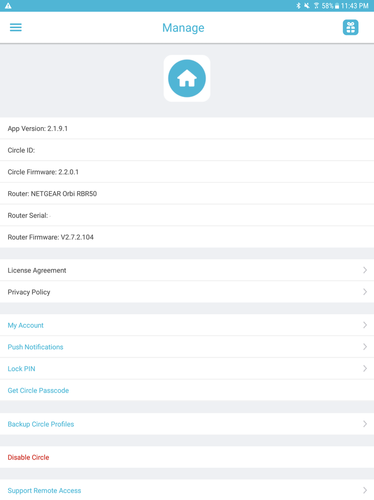

If you were succesful in disabling Circle I would love to know how you did it. I have been unable to find the solution. I also am not very good at community group participation. So I look forword to your reply. Thanks in advance.
- aussteyrFeb 16, 2021StarCan only be disabled via the browser as far as I know.
But its an on or off thing. And like most, if you bought the orbi for its parental controls, then that defeats the purpose of the purchase... - Karl1234Feb 17, 2021Guide
Do you mean disable or enable? If you are looking for the switch then it is on the 'parental controls' of your router login webpage (orbilogin.com)

Karl - FURRYe38Feb 17, 2021Guru - Experienced User
You can disable circle via the Orbi app>select Parental Controls which will open the Circle app:
Select Disable Circle...
