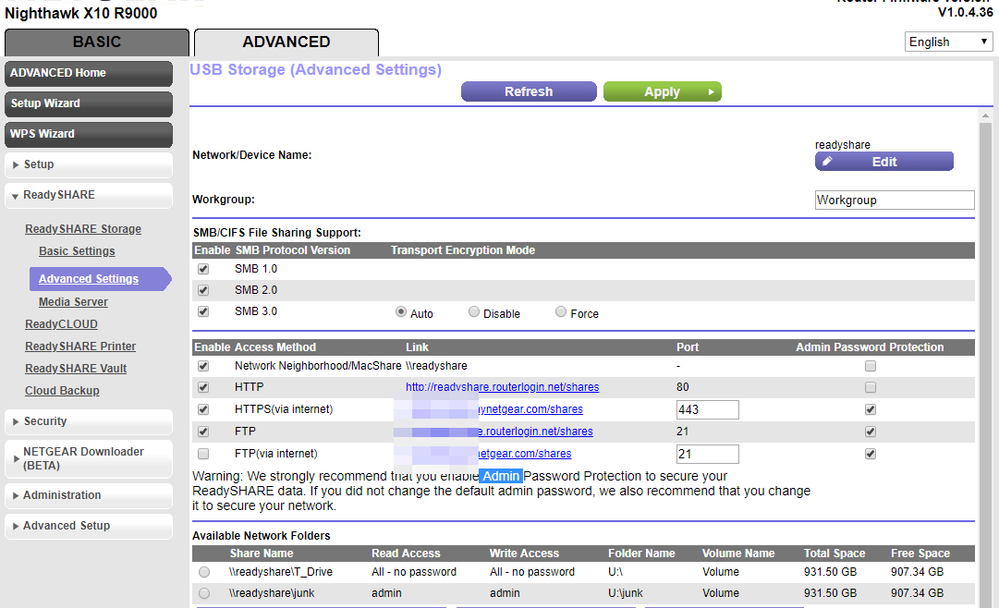

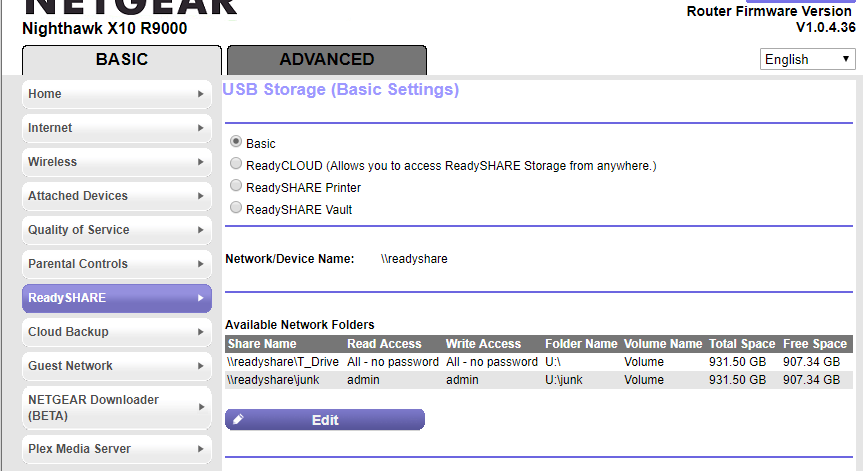

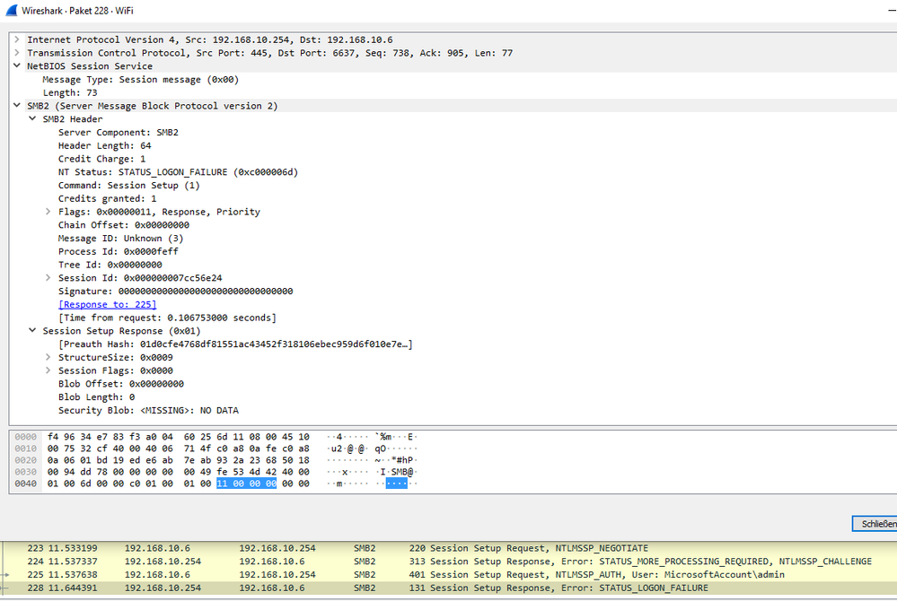

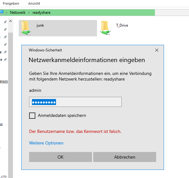

DexterJB as I've mentioned above ... there is no way to connect a Nighthawk hosted shared folder with admin protection on many NTGR routers.
Windows 10 Pro, Version 10.0.18362 Build 18362 (up2date of course), no strange optimisations, can connect flawless also to legacy NAS (NetBIOS annoucement/name resolution only, SMB 1.0 only, ... and works nicely on high end NAS using WSD and SMB 3 with negotiated encryption for example).
Example: R9000, 1.0.4.36 Hotfix, no current SMB session to the R9000, and no entries in the Credentials Manager. And yes, the admin password does end with a @ ... that's nothing that must have an impact:
Very misleading that the "Warning" does talk of an "Admin Password" ... username and password are case sensitive, and there is NO Admin account, only admin.
And yes, I know the admin password...
