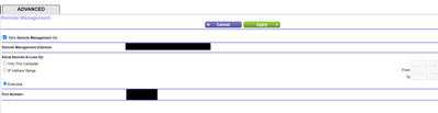

- Tyler818Aug 28, 2022Aspirant
For testing I thought I would try enabling Remote Management but It appears as part of my testing yesterday I turned on Remote Management and forgot so its actually been on for the last day:
My Anywhere Access issue persists with that feature enabled so I'm included to believe the Netgear page that Anywhere Access feature is a different feature from Remote Management feature.
