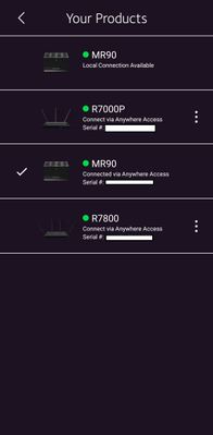

Have you looked at the "Your products" bit?
It may show both. But that may depend on setting up Anywhere Access.
