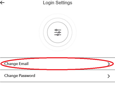

Cannot get Nighthawk to work with new phone
I just attempted to opened my Nighthawk App on a new phone. My app and Netgear account were using a very old email address so I went online and changed my email address to my new one. I am able to lo...

I have attached a screenshot showing sequence of events.
Where did you do that?
mynetgear.com?

Thanks for all your help. I was able to get the Nighthawk app connected to my router. I was overlooking the option to "Login with one-time password". Once I logged in using the one-time password, I was able to connect to the router. Once I was logged in, I enter my credentials for the router. I still would like to know how to get the old email address removed from my netgear account. Thanks again for your help.

- ltaamaNov 21, 2022Tutor
Yes, I changed it there last year when I switched to a new email provider. The old email must be held elsewhere in the system. Thanks again!
