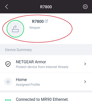

2. You cannot rename devices (for an extender at least) via the Nighthawk app or the web app.There is the hidden "Edit" button in the Network Map. Drill down to the device you want to manage and look for the button next to the device icon.
Of course, some devices don't let you do that because of the way that they are configured. It is there for an AP. but I'm not sure about extenders. They are a bit different and increasingly losing out to Mesh systems. I'd expect to manage an extenders on the device itself.

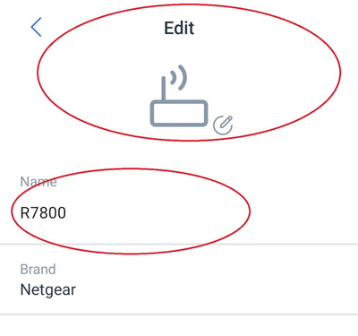

This is for an AP in the NIghthawk app.
Then:
