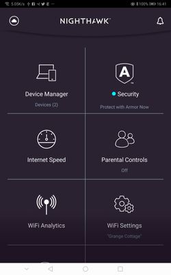

Device manager not displaying devices
Whenever I access my router from the nighthawk app (on my android), I'm not able to see my devices from the device manager. When you select it it seem to open a Parental control page and it display "...

I am trying to use access control, when I log in to the router on my computer it says to use the app.
When I use the app I was getting nothing, just wanted me to set up parental controls.
I updated to the latest firm ware on the router and now I can see devices on the app.
But I still don't see how to turn on access control or how I can allow to devices in.
Also none of the devices in the list have any name next to them, before they had a description.

- michaelkenwardDec 24, 2023Guru - Experienced User
Oats467 wrote:
Access ControlTo use Access Control, please use the Nighthawk App.This is what I see on the computer when I log in to the router.Have you installed the Nighthawk app on a mobile device band completed setting it up?
This requires Anywhere Access. This is turned on by default.It lets you connect the Netgear cloud to manage things like Parental Controls.
Anywhere Access is not the same as Access Control, which is something that you with a web browser and the graphical user interface (GUI) to manage the Internet access for things on your local network. It is not a part of the app's parental controls.
Setting up Anywhere Access take several steps.
First you have to login to the wifi on the device. Then install the Nighthawk app and take it through its setup.
At some stage the app will ask you provide your online Anywhere Access account information to get you into the Netgear cloud system. It will also ask for the router's login details. The same as the admin account you use with the GUI.
