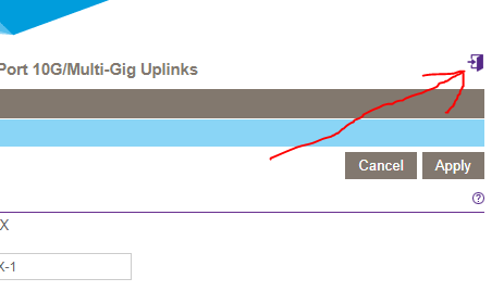

    So, can anyone tell me other than letting the web page timeout, how do you logout of these switches? No logout button in the UI.
    Top right all newish Switch UI have an (non-labeled, sigh....) Logout button:
