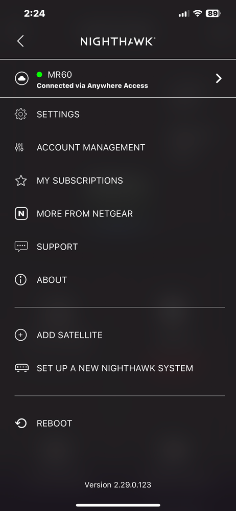

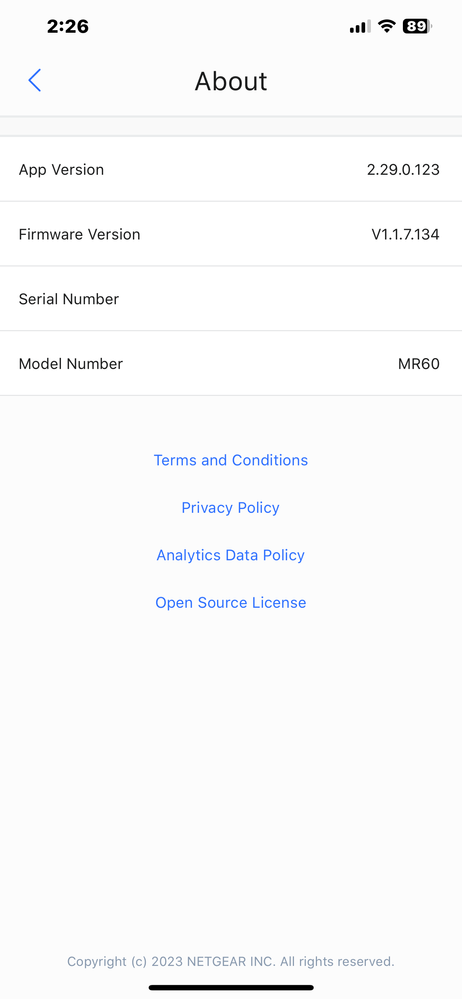

I put my MR60 onine and wanted to check it with the NH app and AA. iPhone 12 Pro Max iOS 16.5.
It's working here. MR is even in a double NAT condition:
