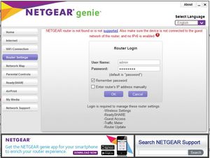

I see there was a topic that seemed to mirror my issue but it did not seem to be solved. I have a 6200v2 router. When I try to use the Netgear Genie I get the following:

Hi Dexter JB,
NETGEAR Genie version 2.4.20
NETGEAR Router Firmware Version V1.0.1.20_1.0.18
Computer is wired to the router.
Thanks for the quick reply.
Jarrod

- jarrodj609Dec 28, 2015Aspirant
Hi Dexter JB,
Thanks for the prompt replies.
I manually updated to the latest version (1.0.3.10).
I uninstalled then reinstalled NETGEAR Genie.
When I try to access parental controls or router settings through NETGEAR Genie it still is not working. My parental controls are "stuck" on a filtering level that effectively blocks adult sites but I cannot adjust the filtering level if necessary and I cannot set-up time restrictions.

- jarrodj609Dec 29, 2015Aspirant
Hi Dexter JB,
If "factory reset" is the small reset button that I need a paperclip to actuate, yes. :)
So I did try to use another computer that's connected to my network via wifi. NOTHING is filtered. I adjusted the filter settings on the https://netgear.opendns.com/ site but it is not working on other devices. This is strange.
