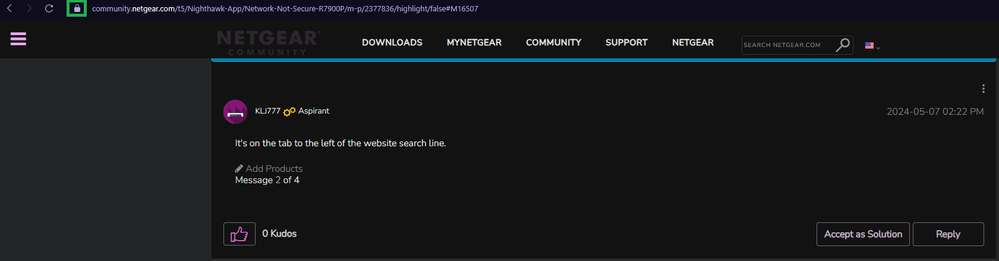

      It's on the tab to the left of the website search line.

        This for all sites you visit?
        What do you see for this forum site? There should be a locked pad lock that indicates a secure connection between the browser and this site.
        What browser are you using? I'm using Opera here. Try a different browser?
        Wireless and security settings is only for security connections between the router and connected wireless devices. Doesn't secure the connection from the router to a web site. That should be all handled by the browser.
