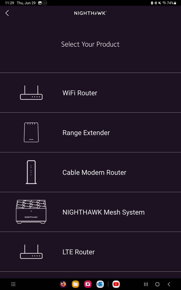

- Select Your Product. Wi-Fi Router for any Nighthawk R, RAX, RAXE or XR series router or Nighthawk MESH System for any MK series models:

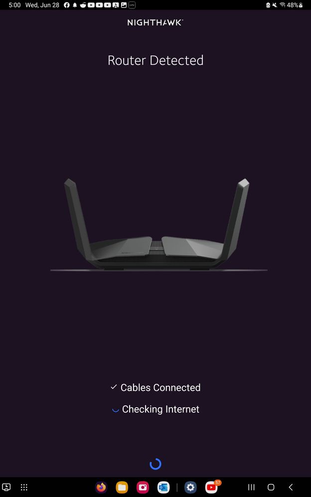

- On the Router Detected page, the app will display it's checking the Cables and Internet connection and service here:

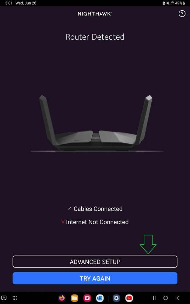

- The Checking Internet will fail and report a problem. If there is a Try Again button seen displayed, select Try Again button. The check will fail and then present a Advanced Setup button. Select the Advanced Setup button:

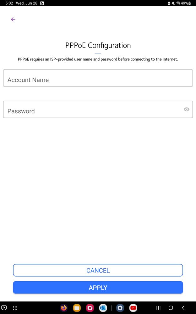

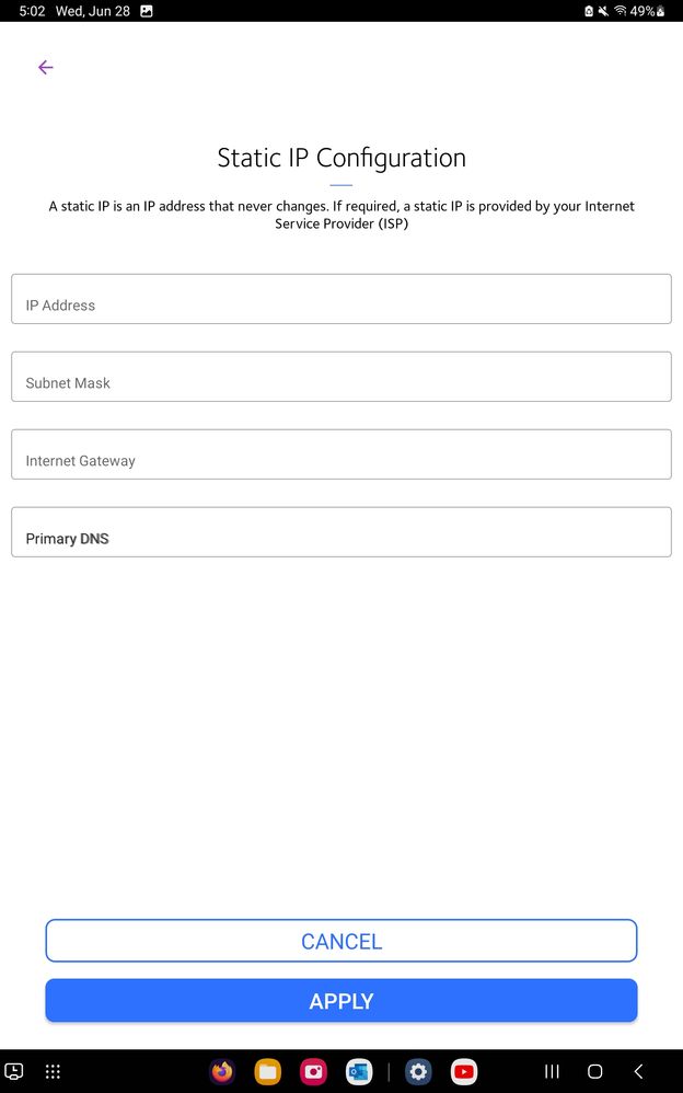

- This will display Advanced Network Setup with two configuration options, Static IP and PPPoE:
- Select from either of these two options to configure the WAN configuration given by the ISP here:
- After ISP WAN Configuration has been entered correctly, Select the Apply button to have the Nighthawk app save and apply the new WAN configuration changes to the router.
