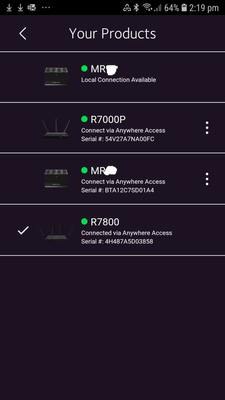

However, I xannot find a place to log out, so that I can switch back and forth when I am in the different locations.You don't. By setting up Anywhere Access you can see both routers from wherever you are.You will see a list of all routers that you have setup for Anywhere Access.
If you are on the same wifi as a router it will offer you the option Local Connection Available.
