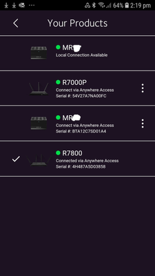

    It works for me with an R7000P and R7800. At least, it does when the app isn't playing up.
    You have to set up each router to work with Anywhere Access.
    How do I enable or disable Anywhere Access on my router using the Nighthawk app? | Answer | NETGEAR Support
    When both are properly configured, the app will show you a list of your devices. Depending on whether you are on local WiFi, connected to one of the routers, you will get the option to use the local connection or Anywhere Access.
    When you are on the Internet, you will be able to choose between the R7000 and R7000P.
