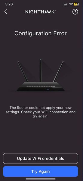

Unable to get through the app set
I got this router to pair with my att router but its not working I updated the wifi credential, and tried again and again... it doesnt work and my router is not working. There's a red ligh...

You don't say which "router pair" you got (Netgear has a useful link that you can click to add this detail), or what the ATT router is, but "not working" is pretty well what you expect if you pile router on router.
Two routers on your network can cause headaches. For example, you can end up with local address problems. Among other things, the other router can misdirect addresses that the Netgear router usually handles, such as routerlogin.net or the usual IP address for a router, 192.168.1.1.
This explains some of the other drawbacks.
What is Double NAT? | Answer | NETGEAR Support
Unless you have specific reasons for using two routers – to create two separate networks for example – it is often easier to use just one router and then to set up the second router as a wifi access point. Netgear advises this, as does just about every site you will visit.
It may be possible to put the modem/router – if that is what you have – into modem only (bridge) mode and then to use the second device as the router. But some Internet service providers, such as BT in the UK, supply modem/routers that won't work in bridge mode. There may be ways to get the modem/router to cooperate. Sometimes it is easier to put the second router into AP mode. But that has its own drawbacks:

The ATT router is BGW210.
In the netgear manual it askes me to connect to my main ISP router and use WAN cable to connect to the netgear router. I tried connecting the phone/internet cable to the "wan" port on netgear and it did not work, so I plugged this cable back to my att router and did what was instructed to do on the manual which is make a connection from the ISP router using WAN port from the att router and plug that to the wan port from netgear router.

That is a modem/router (gateway). Adding a router to that is likely to cause the problems I linked to in my first answer.
We still don't know what Netgear device you are using, but the answer is the same for most routers.
How to fix issues with Double NAT | Answer | NETGEAR Support

AC1750 smart WiFi Router
the phone/internet cable doesn't work on this router, it says to use "wan," i googled it and its a rj45 cable. I used the wan port on both routers to make the connection but it doesn't work.
