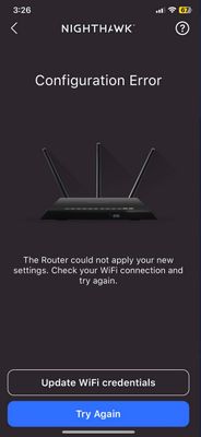

Unable to get through the app set
I got this router to pair with my att router but its not working I updated the wifi credential, and tried again and again... it doesnt work and my router is not working. There's a red ligh...

AC1750 smart WiFi Router
the phone/internet cable doesn't work on this router, it says to use "wan," i googled it and its a rj45 cable. I used the wan port on both routers to make the connection but it doesn't work.

You haven't answered the question about which Netgear device you have. It matters. That picture could be a router. It could be a modem/router.
To connect the unknown (to us) Netgear device to the Internet, you need to plug a cable from an Ethernet port on your gateway (modem/router) into the WAN port of the Netgear router. Which Ethernet port you use on the gateway shouldn't matter. It won't have a "WAN" port.
