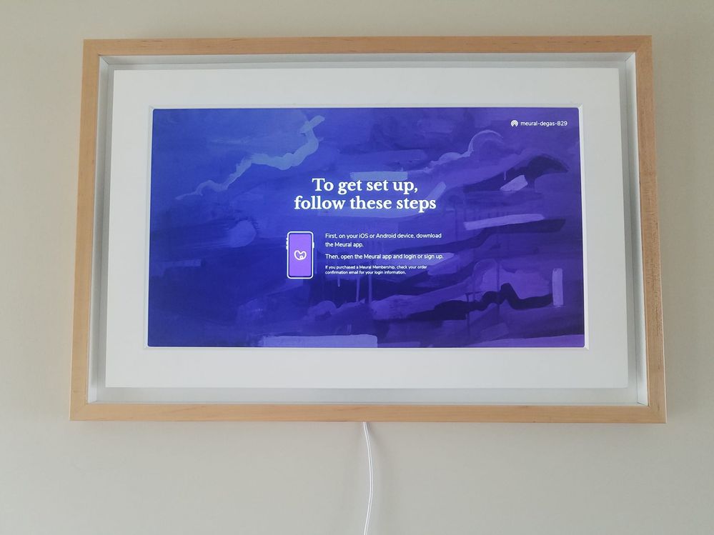

I tried to follow the instructions on Meural app and I am stuck in this screen.

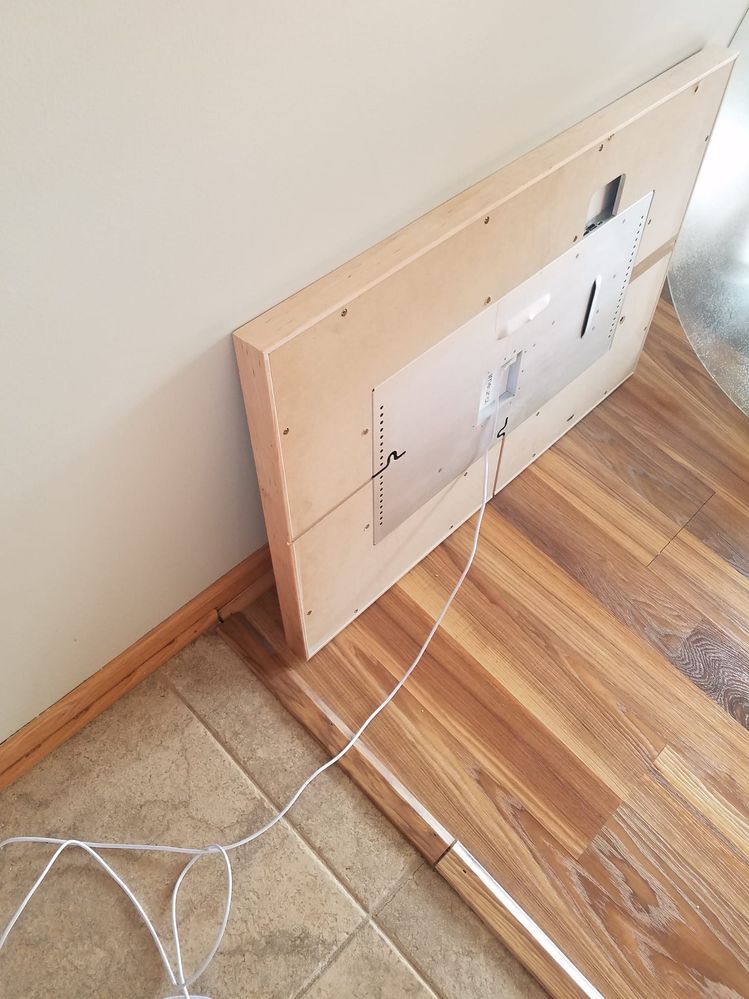

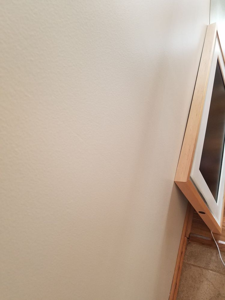

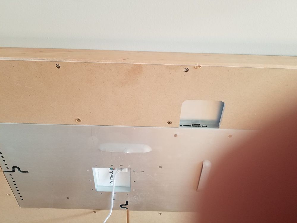

I dont even know where the reset button is on this thing. I have attached some pictures of my canvas. Can anyone help me find the reset button.

      Step1: Press the tiny tiny little reset button right next to the ports.

      Step4: Wait till you see the default meural-wifi on the top, for me it said, "ruben-xyz123"
