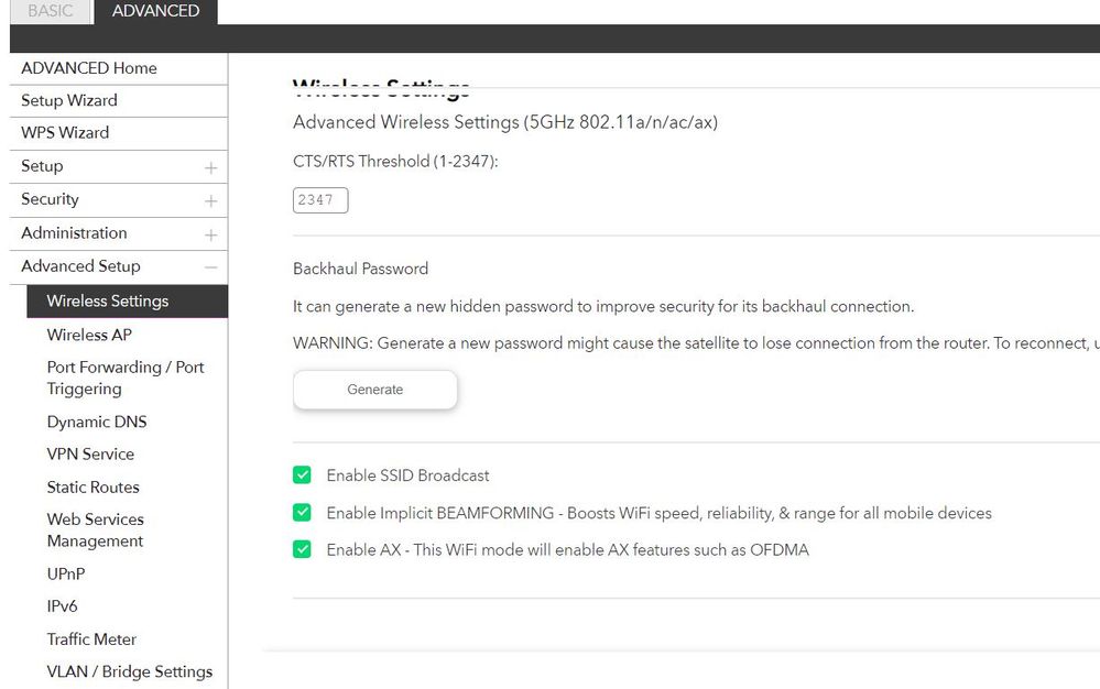

Advanced ----> Advanced Setup ---> Wireless Setting--->Disable/Enable Broadcast SSID setting

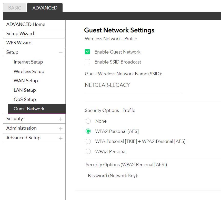

Ok, I just tried that two ways and neither worked. I first did it as you said in the Advanced Settings menu, which made my standard network disappear from visibility (as I understand it's supposed to with SSID turned off). My guest network was still visible so I used that, but the deivce still can't connect to it.
I then tried the reverse, disabling SSID on the Guest network and turning it back on for the main network. Same issue, the 2.4GHz-only devices won't connect.
