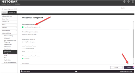

Can't Turn Remote Management Off - MR60 Mesh Router
If anyone can help I appreciate it. I have the latest firmware. I am just trying to turn off the Remove Management. When I unselect and then hit Apply it does not save the setting, and turns it...
- Aug 25, 2023
Ok, lets try a Factory reset and setup from scratch.
bryansdiego
Aug 27, 2023Aspirant
THANK YOU SO MUCH, this WORKED!!!
I erased all router settings, then hit the factory reset button on the router. Then I reconnected it from scratch. Even though I did have the latest firmware before, this time the "remote management" option disappeared!!!
I am good to go and thanks!
