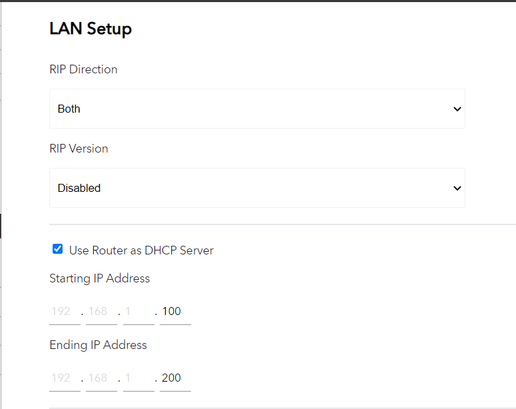

Recommend setting the default DHCP IP address pool range to the following after applying and a factory reset: 192.168.#.100 to 192.168.#.200.
I want to make sure I'm understanding your request correctly.
To do this I need to log onto my router, select Advanced > LAN Setup > Use Router as DHCP Server needs to be checked off > Set Starting IP Address to 192.168.1.100 > Set Ending IP Address to 192.168.1.200 ... or is that incorrect?
- FURRYe38Jan 13, 2023Guru - Experienced User
Correct on making changes to the LAN DHCP service.

Okay, I've unplugged modem, router, restarted PCs then went in and set the IP address pool for DHCP as shown in screenshot below.
