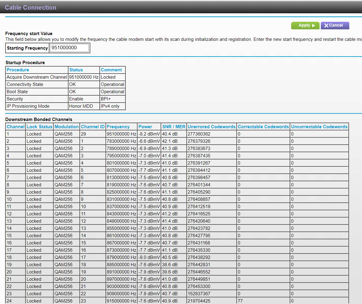

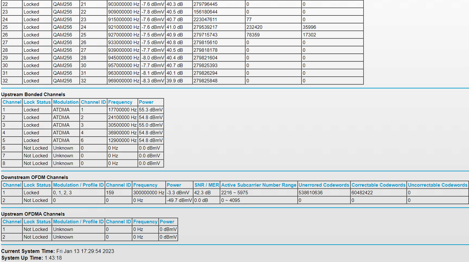

Here is a screenshot of the modem's connection status and modem's event log:
- FURRYe38Jan 13, 2023Guru - Experienced User
Please post a copy and paste of the modems connection status:
https://kb.netgear.com/30007/How-do-I-obtain-the-cable-connection-information-from-a-NETGEAR-cable-modem-modem-routerI see lots of Criticals that needs to be looked at by the ISP to resolve them.
- AK89Jan 13, 2023Aspirant
Here's the cable connection info:
