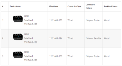

I manually updated my MR70 and MS70's to v1.0.3.32 this morning. I tried to add one of my old MS60's (v1.1.7.132) via a wired connection through a GB switch and it seems to be working. I initially tried the wireless sync, but it timed out. I plugged it in to ethernet and got the blue light and see it on the devices table.

Well, I may have spoken too soon. The MS60 was running fine for the last couple of hours with the blue light so I went to move it to a better location and after startup I got the orange light again. Before that I was able to see it on my NetSpot with a strong wifi signal as it was right next to me.
I tried changing the patch cable and then eventually moved it back to the same place it was originally working and still get the orange light after the startup flashing white light. I could hit it by IP and could login, but I got a message saying it isn't connecting to the network with a list of various reasons.
I then tried a full reset of the device and still get the orange light, plus now I'm getting a 404 Not Found when I try to login. The "Attached Device" list still shows it "Wired" with "Good" backhaul status, but it's obviously not working right anymore.
I'll keep you posted if anything changes after further troubleshooting efforts, but seems like the new firmware on the MR70 didn't fully solve the compatibility with the MS60. It shouldn't be this complicated.
