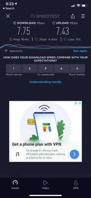

As soon as 1st install. updated to 1.1.5.4 first wireless and 2nd time wired. the speed didnt seem ok. every two to 4 days. the spped was droping below 7Mbps and only rebooting would fix it. So updated to 1.1.6.4 . But this one. takes away the ability to see the connected devices on the network map of the app. I can see the router and the satelites but when clicking on them. it does the loading thing but nothing is found. the devices all show up on the device list. but the list doesn't say to what satelite or router they are connected to. and every once in a while. I'll get a message on the app. that a device was found. and when I look. is listed in the network map. for example my apple watch or the ring door bell. and later it disapears again from the map. but they are still connected and on the device list. in 1.1.5.4 you can see all the devices in the network map. under each satelite and the router. and on the device list. each device shows what is connected to.

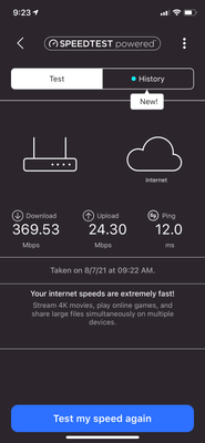

One of the times that I was checking on the speed issue with 1.1.5.4 . I spoke to my ISP Spectrum cable.. and they said that it showed I was running the speed test using the 2G connection and not the 5G. but when looking in the map and the web page. everything looked like it was connected to the correct connection. 2G devices listed under 2G and 5G devices connected to the 5G.

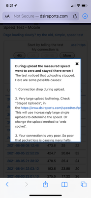

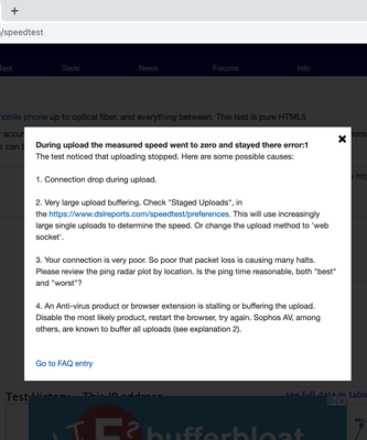

screen shots from Macbook pro Safari browser ver. 14.11 and Chrome 92.0.4515.131 and iPhone XS . the Nighthawk app reports good and the speed test app doesn't.
