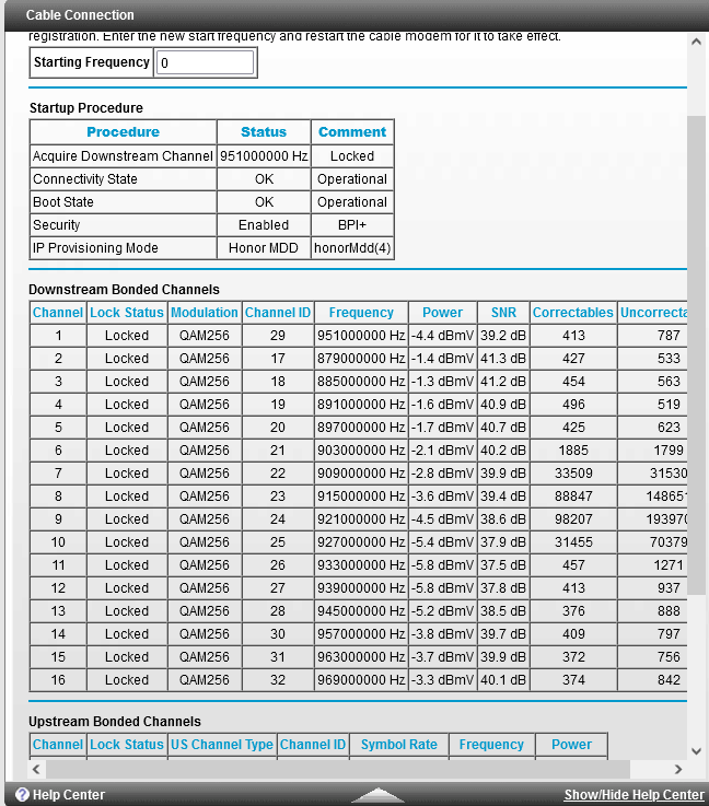

- santeeslimMay 06, 2022Tutor
I think this is what you want, and no, I haven't replaced any cables. CORRECTIOIN: I have my deskto PC connected to the router with an ethernet cable.
- plemansMay 06, 2022Guru - Experienced User
you've got quite few errors in your line. We're missing the logs and the upstream info but right now its looking like a line issue.
Start with removing any amplifiers, signal attenuators, or splitters from the coax.
From there check the line for kinks, damage, moisture in the line.
Check the connectors for improperly made ends, foil touching the copper coax line, bad/old/cheap connectors, or corroded connections. Replace them if you do.
If you can, simply connect the modem right where the coax comes into the home. This prevents wiring in the home from being the issue. And some ISP’s charge if the wiring issue is in the home. So this helps prevent this.
