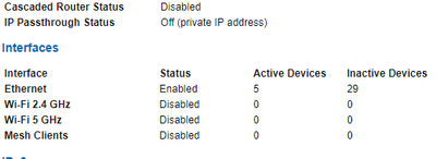

Sorry I should have mentioned that my Modem is already set to modem only and the router and wifi part disabled. The Modem is a BGW210-700
Also for these options that need me to login to routerlogin.net, I can't access that page as it redirects me here.- FURRYe38Oct 06, 2022Guru - Experienced User

- MattQOct 06, 2022Aspirant
Yes, the IP address is 192.168.1.something.
Also yes, I believe so that modem is in full modem mode. When I check my ISP's webpage for it, all signs point to it as I can see.Also thanks for helping and sorry for these late responses
