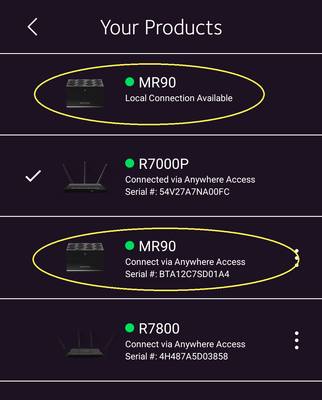

You should also see the option to use local access. This is for my slightly more complicated setup.
With Anywhere Access you are connecting to MyNetgear using the Cloud service. In other words, you are not connecting to the local WiFi option.
This could explain why you can do things like run the speed test with that connection. You don't have to be connected to the local WiFi to make that happen.
If you don't see Local Connection Available you aren't on the local WiFi.
In Anywhere Access you can see the WiFi settings here:
- Settings
- WiFi Settings
- WiFi Network
Check that everything there is as expected.
You may have to remove and reinstall the NightHawk App.
